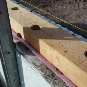

I have also seen them do the above but for a wood top plate on an ICF wall. They place a pink foam under the wood top plate to protect the wood and prevent moisture transmission from the curing concrete. The difference is the wood top plate is left in place and not removed.
