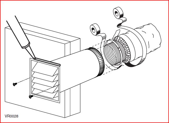

Can anyone point me to a detail for passing HRV ports through a thickly insulated envelope?
I haven’t decided yet whether I will pass the ports through the rim board assembly or the wall above – I’m leaning towards the wall above so as to lift the ports well above the winter snow line.
The manufacturer’s installation detail calls for simply passing through a 6″ galvanized round duct… but I’m not sure I like this approach.

    I've never heard of 6.5 inch or 7 inch PVC pipe. But there is nothing wrong with your idea.
    However, remember that most walls are insulated anyway. Presumably the galvanized pipe that penetrates the wall will be surrounded by insulation, no matter how you detail the penetration.
    One important point: the pipe should slope outwards, so that any condensation drips outside of your house.

    Seems like sleeving the pipe is going to create an added flashing hassle later on. I would run the duct right through the wall, through a 2x block, then flash the block as you install WRB and siding. A sleeve is only useful if you need to install the duct later for some reason, or need to be able to remove/replace the duct down the road. We install sleeves for plumbing pipes through concrete foundations, but that's usually because we're ahead of the plumber, so we leave him access that doesn't require core-drilling. In a wood wall, no reason for that.

    My concern was that, with a wall assembly that is relatively vapour open to the exterior, under certain conditions there might be a risk that the [outside of the] galvanized duct might "sweat" in the wall...

    So the concern is that the exhaust port might have cool enough air in it to reach dewpoint on the outside of the metal, inside the wall somewhere, when it's hot/humid outdoors?
    I suppose in that case, your strategy of installing a sleeve around the pipe, filled solid with one-part foam, would prevent that. If you do this, I would terminate the sleeve on the inside face of the sheathing and only penetrate with the duct itself, unless you're prepared to do some fancy flashing work to leak-proof the whole thing... which of course you could do. What does your wall cap look like?

    I haven't heard of galvanized steel duct being an issue in practice in any climate. If you're really concerned about it though, you could also consider using Zehnder's "Comfopipe", made from Expanded Polypropylene.

    I have been refering to thisJLC article.
    In it, the author describes using PVC at the ports, but it seems like a slightly different application...
    We use a short (about 6- to 12-inch) section of 6-inch PVC pipe (including a bell end) to connect the insulated flex duct to the vent hood. We cut a series of 1-inch slots, about 11/2 inches apart, in the male end of the pipe section, and then slip the flex duct over the PVC. The connection is sealed with aluminum tape and screws. We insert the bell end of the PVC through the hole in the building, flush with the outside face of the trim block. The Jenn-Air hood is then inserted into the PVC.
    Anyway, I really don't want to use PVC at all if I don't have to...
    I'm open to other suggestions on how some kind of impermeable insulation could be applied to the exterior of the galvanized duct.
    Or whether this is even an issue at all - I'm not sure it isn't but I'm not sure it is either.
