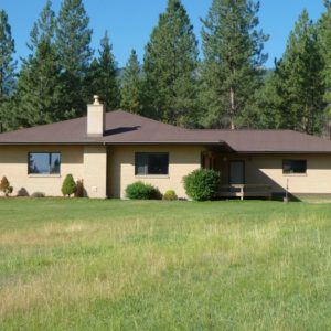

    John K:我同意突出问题,更大更好。我在MT的叔叔家里看到了4'突出了,我必须在今年夏天去那里旅行,以便在他说他只使用电动墙(不是​​底板)加热器加热150-00美元/年后,为自己看。但他的位置是另一个故事。这是一个悬垂的照片。

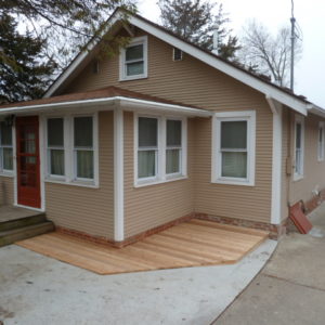

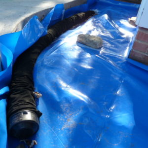

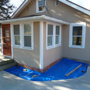

    I know this is a 'very old' post, but I just wanted to update the thread with photos of the progress. I appreciated all the comments and ideas and I'm happy with how it turned out so far.
