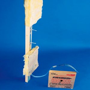

> Insul-Hold
Worth asking if it will work. Or adhesive sounds good.

I've also found a product called Insul-Hold (seems like maybe made by 2 different companies) that looks interesting. Not sure if it would hold these heavier/thicker batts though...

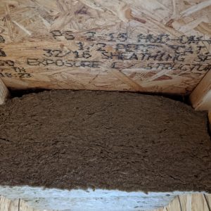

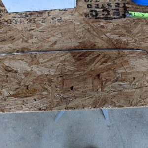

所以今天早上,我试着bendin我的想法之一g a 24" wire insulation support into a 4-16-4 squared U shape (see pic). I then used this with a batt in the cavity. This seems to work really well. The slight compression puts enough pressure to push the batt to the roof deck. The 4" on either side (which rests on the top of the bottom flange make it a no-brainer to install. The squared shape doesn't put differing pressure across the batt width as they normally would. Also bending the support is alot easier than cutting them. So, I think this is the way I will proceed...
I bet I could even make a little relief cut 1" deep down both sides of the top lengths of the batt which would prevent that little gap by the flange.
Looks pretty good. I would get some 3/4" rigid or R8 rolls and fill in the sides. You don't want gaps around batts.
