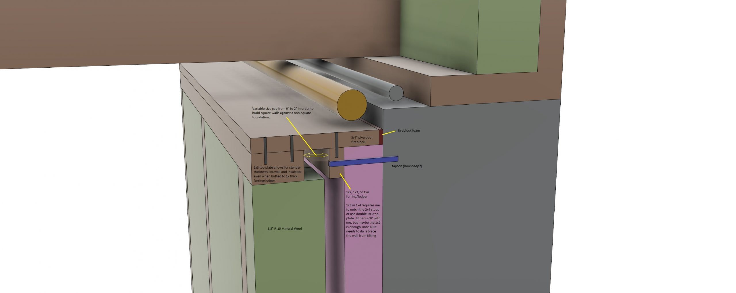

我装修地下室在芝加哥地区I thought I had it all sorted out. I was planning to put 2″ XPS and then a 2×4 stud wall with mineral wool, fill the rim joists with mineral wool (and maybe XPS) but leave them accessible for future needs, and leave the joists exposed but painted black. Then I started reading about fire blocking and condensation and after doing weeks of research I’m incredibly confused and no longer have any idea what to do. I’ve included pictures so you can see what I was planning to do and what I’m stuck dealing with.

Solution(?):Maybe I could simply build the walls shorter? Instead of going all the way up to the joists I can stop 3-4″ below that to clear the obstructions. I’m leaving the joists exposed and would like at least some access to the rim joists anyways. If it looks bad I could hide it with some crown molding or something. I’d still need to secure and fireblock the top of the wall though. Not load bearing of course, just needs to prevent the wall from tilting in or out. But how?
– 1×3 or 2×4 PT ledger against the foundation wall, run the XPS up to the bottom of it, then use braces or plywood to secure the wall to the ledger.
– Ledger (regular or PT?) against the XPS, sandwiching the XPS between the ledger and the foundation, and use some sort of braces or plywood to secure the wall to the ledger.
– Same as above but put the “ledger” on the back of the 2×4 wall, eliminating the need for bracing but needing longer bolts.
——胶合板条上的墙,spanning the distance to the foundation, and attached to the foundation with angle brackets.
In any case I could cap the top of my slightly-short wall and the gap behind it where the XPS is with some combination of plywood, drywall, and maybe even more XPS to provide fireblocking and thermal breaks. I’m really not sure on the details though. I’m afraid that I’ll do something in a way that causes condensation and mold or breaks the thermal barrier in a way that negates the point of the insulation to begin with. I also need to deal with the plumbing against the wall. Perhaps I only insulate below the waste pipes but not above them? It wouldn’t be as efficient of course but that would still be better than no insulation anywhere. Or would it?

Could you explain how you'd do the furring strips a little more? The foundation wall is a little wavy and out of square so in order to make straight and square walls I'll need to space them 0-2" away from the foundation. How would you manage that variable gap? 2-3 rows of horizontal furring strips then build a straight 2x4 stud wall in front and use some sort of blocking between the wall and the furring strips to manage the gap? I'm attaching a picture of how I was thinking to use a single furring strip/ledger at the top of the XPS to brace it and support the fireblocking at the top but I think you're suggesting an easier and simpler way that I'm not quite understanding.

The experts could help you better here but if you need to build a 2x4 wall and you are worried about straightness take a 2x4 and attach it to the joists past the sewage pipe. Then box in your sewage pipe like an L ending under the pipe and in front of your insulation. Then you can build a wall and attach your top plate to the box out. Just don't use long nails and nail right into your sewage pipe. Just find where the wall sticks out the most and line up your 2x4 wall to that. Leave the gap, you already have your continuous insulation and wall will be straight.

I was thinking about a soffit but it would be at about shoulder height so not super safe. I think what I will do is position this entire wall an extra 2" from the foundation and use some spray foam around the pipe to prevent condensation. It will be 8" of wall instead of 6" but the pipe would be entirely enclosed (except cleanouts etc of course, small closet for that) and insulated enough to hopefully prevent condensation.
I'm planning to put up the foam first and then I can use a laser to find and mark the tightest straight line for the stud wall. At the same time I can use the same laser line to mark the piece of plywood I would use to brace the top of the wall and ensure everything is plumb.
