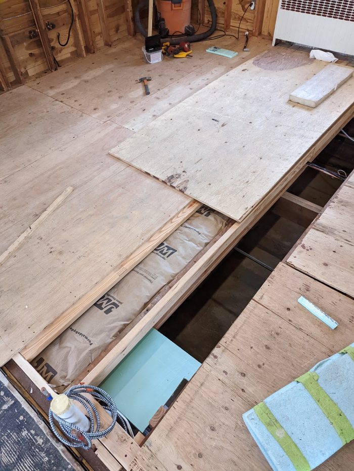

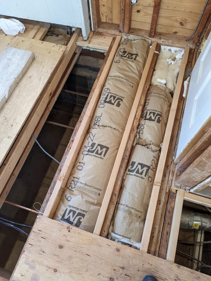

Need some guidance. Essentially, we gutted the kitchen to the studs, opened up some walls and kitchen floor was stripped. This opened access to crawl space beneath the kitchen floor. We decided to put rigid foam on joists (1” thick) and then spray foamed the gaps around it (see picture). For insulating the floor, we first laid down ¾ rigid foam (R4) and then put bats on top (R21).

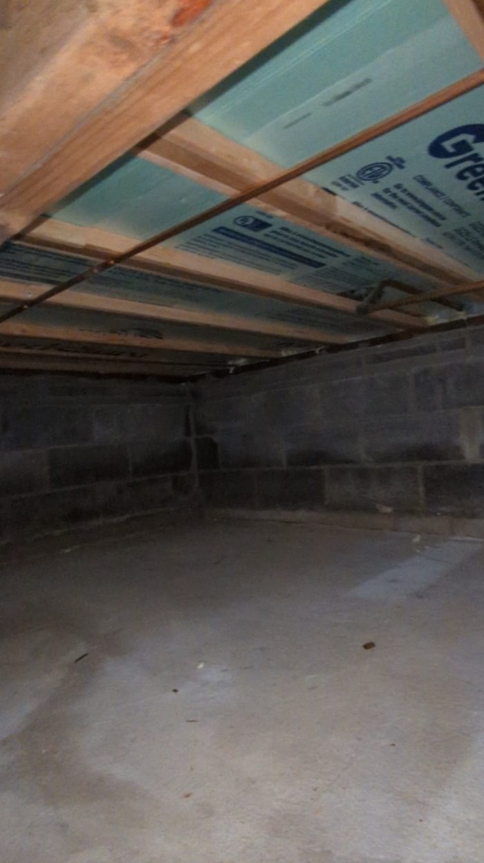

我的问题是:这个爬行空间应该发泄吗?All the walls and floor in the crawlspace are concrete (except a small window) which connects to laundry room in the basement. I noticed that the walls have signs water or previously being wet (see picture attached).
