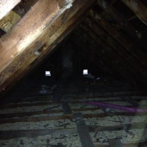

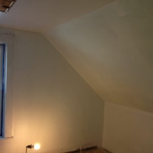

我正在佛蒙特州中部修理1850年代的斗篷。阁楼目前在托梁之间的灰尘上有大约一英寸的ver虫。墙壁被吹了进去,但显然仅到楼上窗户底部的水平。我想将阁楼从屋檐下吹到墙壁顶部,以使其具有绝缘的全高。我还想将纤维素中的阁楼地板隔离到R-48至R-60范围内的某个地方。我的问题是第二个故事中的屋檐和膝盖墙倾斜天花板。

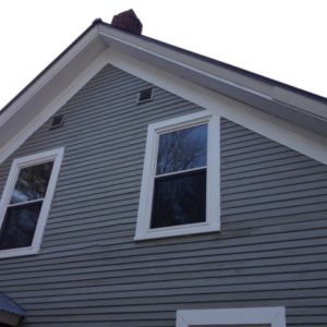

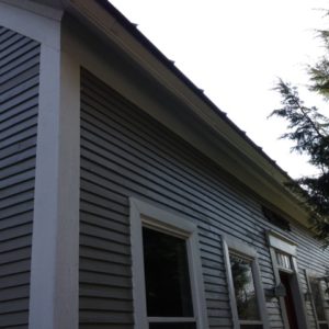

这所房子没有拱形通风口,在过去的150年中,如果没有它们,似乎相处得很好。如图所示,有4个小通风口,在房屋的两端有2个。I’d like to be able to just blow insulation down the eaves fill the wall cavity and then just keep filling till full then do the floor but this goes against most conventional wisdom on airflow, but most of this is based newer construction methods and on having soffit vents…
The attic space is minimal about 32’x14, and maybe 7 feet at the peak. The roof is trussed with 2×4 construction and with nails coming down from the roof and very little space to work in Im not sure how I would get some sort of air space baffle in there at all. Any tips ideas? Oh its a brand new standing seam metal roof at about a 11:12 pitch I’m not too concerned about ice dams even with the old galvanized roof it shed the snow just fine. I have attached some pictures of the attic, the eave space one of the upstairs rooms (mid restoration) and a couple outdoor pictures.

    Too bad there is a new roof. The best way to insulate these old Capes is with rigid foam above the roof sheathing, so whoever made the decision to install a new standing-seam roof without installing rigid foam lost a golden opportunity -- an opportunity that won't return for about 70 years, when the roofing finally wears out.
    You've got some headaches. Hurdle number one is the vermiculite. You have to assume that it contains asbestos. Stay out of the attic. Don't disturb the vermiculite in any way. You can't do any air sealing or insulation work until you've paid for an asbestos abatement contractor to remove the vermiculite. Bummer.
    For information on the various options you have for insulating the sloped ceiling, seeHow to Build an Insulated Cathedral Ceiling。有关绝缘膝盖的信息,请参阅Two ways to insulate attic kneewalls。
