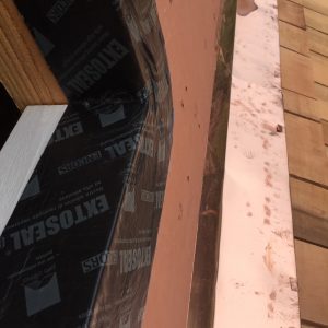

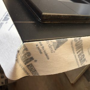

Hi Peter,
It is sloped. We placed a piece of beveled cedar on the sill then taped with Extoseal. The picture shows a 6" nominal piece of cedar but after the first few windows we decided to rip the cedar down to the width of the window frame to make it easier when installing the finished interior window sill. After the windows were installed, I taped the outside with ProClima's vapor open tape. On the inside, I used ProClima's vapor closed tape. For the operable windows that we installed using screws, I was able to attach the tape to the frame first which avoids the whole tape seam on the face issue and is quicker and easier than taping afterwards in my opinion. I happened to order the windows with the aluminum cladding cut back which made it much easier to tape the exterior and to affix the trim. The trim has head flashing, first half of the install without end dams, the second with the end dams (thanks Malcolm). The sills are Azek that we sloped 10 degrees and added a kerf cut on the underside.
