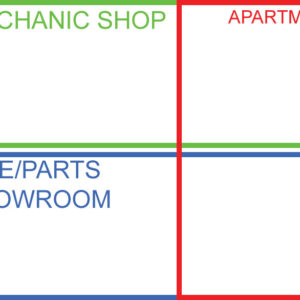

Thank you guys for your replies. I woke up this morning to the worst gas smell in a while, customers bike leaked all over the ground. The whole showroom and apartment smelled so o bad, moved everything outside and let fresh air blow through. I hope to get this done before winter, because this will not be an option. I attached a quick write up of the way my building is laid out 60X40 FT with 16FT ceilings(7 in apartment). I am willing to attach photos of the building, if needed.
The HVAC system is used to heat the whole building in the winter, and is located in the back of apartment. During the summer, I use HVAC metal tape to block off the clod air return used in back shop, also turn damper off to the supply for the shop. I recently upgraded our furnace and would like to keep it supply both, if possible. If not, I may need to find a cheaper alternative to supply heat to back shop only.

Yes Everything is accessible. If you refer to my picture, furnace is located in back of apartment(above shop), then the return and supply trunk line run piggy back down the dividing wall on the showroom side. The 6IN supplies to the apartment is the only ones I can not reach once they leave the trunk, they are dry walled in the ceiling.
