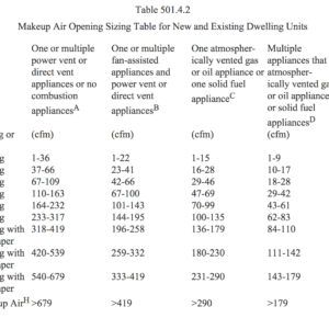

We are in Minnesota (Zone 6a). 2200 sq/ft single level, slab on grade. We have a heat pump (no central ducted system) and an HRV.
我的HVAC承包商和我错过/忘了规划弥补空气的策略。即使我提交了表501.3.1为我的建筑许可证并确定了我需要一个4英寸的无源管道,请使用300 CFM系列引擎盖风扇39 CFM化妆空气,我们刚刚忘了这一要求。

Unfortunately the energy code in MN, for new construction, says differently, or at least my inspector says differently. To quote him "You need to provide make up air for all exhausted appliances. If range hood exhausts over 400cfm it needs to be interlocked with make-up air unit(device) and air needs to be tempered."
对于那些我们需要单位的时间来说,我很开心一个窗户,但我认为我的检查员不会发现可以接受。基于表501.3.1我在这里发布的501.4.2附近,我需要提供4“被动构成空气管道。如果您有一些建议,我很想知道它

That table is a disgrace. Very hard to understand. I like how they force you to put a 3" hole in your house in order to provide 1cfm of makeup air. Makes perfect sense.
