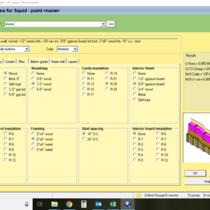

Same question on wall U value, it calculates U-nom of 0.053 and a MJ8 U-value of 0.065? I run a parallel r-value calc on the wall assembly and it appears that MJ8 already has a 25+ framing consideration in their U-nom?
Is there a source for these considerations/de-rations? I scoured the help section and google. They state not to cook the input numbers, but then it appears the numbers are pre-cooked anyways?
