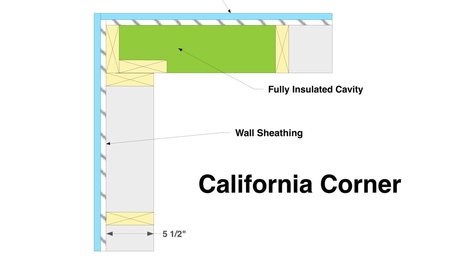

    If the closet corners with the condensation & mold are exterior, where two exterior walls meet the corner framing may be uninsulated (common), with a significant thermal bridge making that corner extra-cold, and may have nothing to do with attic insulation. It may take some drilling &/or exploratory house surgery to figure out how your corners are framed, but if there's an uninsulated mini-cavity on the exterior it may be possible to squirt some cellulose or low-rise closed cell foam in there. In typical 3-stud corners in new construction there is sometimes batt or board insulation stuffed in there:
    https://basc.pnnl.gov/sites/default/files/styles/large/public/cad-previews/445a_CAD_5af_3_Stud_Corner_with_Rigid_insulation_5-00007_GBA_3-6-12_0.jpeg?itok=F9oWEQt2
    Even if it's not an exterior corner, the framing at the partition wall may have left a gap leaving it extra-cold (especially if it's leaking outdoor air) a gap that may be treatable with spot blown insulation or slow rise foam:
    https://basc.pnnl.gov/sites/default/files/styles/large/public/cad-previews/445d_CAD_4af_Interior_Intersecting_Wall_2_Stud_Rigid_Insulation_5-00011_GBA_3-6-12_0.jpeg?itok=BZodvvYZ
    In new construction there are other options for insulated corners, which probably isn't how your house was built:
    https://s3.amazonaws.com/finehomebuilding.s3.tauntoncloud.com/app/uploads/2016/07/29080319/traditional-vs-advanced-framing_news-main-700x362.jpg
    https://s3.amazonaws.com/finehomebuilding.s3.tauntoncloud.com/app/uploads/2016/04/09221413/Image_2-thumb2.jpg
