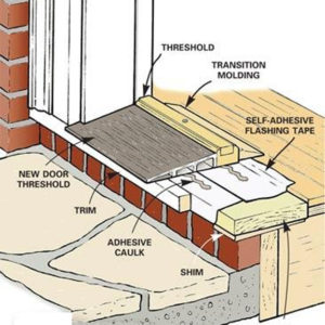

The details will vary from job to job, depending on the relation of the foundation to the above-grade walls. In your case, where the rigid foam overhangs the foundation, the easiest solution is to install the door on a pressure-treated subsill (a 2x8 or 2x10). The illustration below does not really apply to your case, but gives you an idea of what I'm talking about.
In situations with so much rigid foam that a 2x8 or 2x10 subsill provides insufficient support, the answer is probably to design a wider foundation or to install an innie door.
For more information on installing exterior doors in thick walls, seeWindows and Doors in Double-Stud Walls.

I looked at that picture and am wondering how the subsill would be different from a jamb extension? Also, if I frame my walls with 2x4, but the RO with 2x6 or 2x8 would that give me enough support under the door and a decent place to screw in the jamb and still have a fully operational outie door?
Thanks!
The big difference between a door sill and a jamb extension is that the door sill has to support the weight of traffic. People, and especially furniture on mover's handcarts are pretty heavy. A 2x subsill can extend a couple of inches without trouble. More than that, and you either have to fasten blocking under the sill, or go with an innie door like Martin says. I've done sills as much as 4" out, with solid PT blocking fastened to the foundation under the sill. You could probably do more if you really want to, with solid blocking and/or steel angle. You just have to consider the heaviest weight that it will ever have to support.
