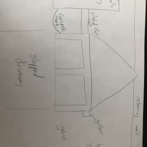

    所以我画了一张我处理的东西的照片。原始计划从车库的右侧射出水,但物业后部有一个挡土墙。如果我挖下然后钻一个挡住墙,我害怕它会破坏墙壁。到物业后部是商业企业。从车库门的左侧开始,我思考射击右边的管道,然后将其伸出到车库的一侧,然后肘击到距离车库的院子里的圆顶。不确定这是否太多了。我也不想挖掘一个深孔的管道。我的起始深度是多少,我有多深,所以我可以在一侧的顶部种植草。也是如果我在院子里的车库前面投球到干得干燥的话。让排水沟在后方挡住挡土墙上,只需用砾石沿一侧挖沟,盖上草地,所以表面水将下降下方。

      You don't really need any particular depth, but if the line is very near the surface it will be more liekly to get damaged. If you can only get the line in a few inches underground, I would use schedule 40 (or even scheduel 80) pipe, and NOT the cheaper schedule 30 stuff with the bell ends that is thinner walled.
      Typical pitch is 1/8" to 1/4" per foot, which is 1-1/4" to 2-1/2" slope per 10 foot stick of pipe. Steeper slopes create faster flow, and allow for more water to be carried by a given size pipe. There are charts to help you size the pipe based on the expected rainfall rates in inches per hour for your area.
      Note that smooth-wall pipe is much less prone to clogging than the corrugated stuff.
