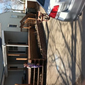

We are building a wrap around porch that extends 6′. Since we know, because of code we have to use 6×6 for the posts for the deck, I have question about the posts that supper the roof.
One way is to use the same 6×6 and extend it from footer to header. We think that since these posts will be 6′ apart going around the porch it might seem a bit too bulky.
Does code allow you to replace 6×6 posts with a PVC reinforced porch posts (they are turned and look like traditional porch posts)? Or do we have to stick with 6×6 lumber?

目前的职位是4 x4雪松,这些职位re far substantial than the old ones. We live in Iowa and certainly snow is an issue, the porch has a fairly low pitch 4/12. We are setting them 6' apart because of this, just to be safe.

From what I've found my roof load looks to be 40 as a max. The current header is a doubled 2x8. I don't want to get too much larger than that because the porch eave is slightly below the height of a door (it's lower than the normal 8ft.) Anything larger than a 2x8 header starts to take up significant sightline from the porch. It's my understanding that a doubled 2x8 should span a max of 8ft. Is this correct?
The reason for asking about the 6x6s initially was because I've been told, according to code, these are the only acceptable posts to use in framing a deck/porch. If that's the case, I agree the only way i can make the porch seem less bulky is to space them farther apart than 6',....if that's possible given my header size.

So, is it true that 4x4s can no longer be used as support posts for porch roofs? Because of where the windows/doors are located, I'd prefer to use 4x4s every 6 ft. Otherwise, I've got to span at least 12' to make it look correct and avoid placing posts right in the middle of windows and also Be offset from the corners of my house... given my porch depth will only be 6' around 3 sides of the house.
