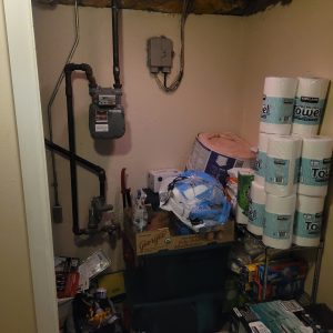

在我的联排别墅里,有一个非常重要的空气泄漏,在右侧的rim jogist / sublloor / partywall相交(你可以看到玻璃纤维batt是多么脏了)。在加方面,目前的水分含量可以是,没有木质腐烂的迹象,我认为在寒冷的天气中可能是一个问题,特别是在墙上的网站上。
通常,我将用刚性板和空气密封的绝缘没有问题,除了有两个问题给出暂停:1)轮辋托梁部分嵌入到党的墙中,2)部分rimjoist在另一侧的混凝土楼梯上升。
我附上一些照片来给出更好的想法。内外图片。
因此,主要问题是 - 这个边缘托珥是可以对空调和绝缘的可以是可以的 - 或者我应该专注于空气密封主要漏洞点。
绝缘是相当容易的,因为所有其他托梁平行于前/后基墙,所以我只需要一条长长的刚性泡沫。

    如果是我的房子,我会担心改变这个区域。由于空气运动,它可能是嵌入的托托斯状况良好。是否有空间在地下室内建造一个新的轴承墙?

      谢谢你的反应史蒂夫。您可能是对这一领域的能量流量的增加,防止了任何重大问题 - 如果它从空气流蒸发,则不能有水问题。
      只要建立一个隔断墙——我of could, but the options are a bit limited. There are utilities and electrical conduits on this wall as well as a plumbing air stack even more left of this picture was well as forced air ducts and a dryer vent duct which run under the joists (to the left of the picture) . Edit: Also the water main enters to the left over in the corner as well.
      I think the spray foam for major air leakages and leaving uninsulated and vapor open/air open insulation or no insulation is the way to go for this area - at least with the a non adhered insulation I have access to the board and can inspect fairly easily.
      我有兴趣了解木材的温度,因为只有一小部分实际上是高于等级。不得不记得把我的红外枪带回家。

    有一些原因涉及绝缘这一领域,因为绝缘将加剧任何水分问题,并且可以使木材更容易腐烂和恶化。如果你真的想在这里隔离,请使用薄(ISH)的EPS层,下面1“厚,未透露。EPS是刚性泡沫的最蒸气,所以在这里使用它是最安全的。
    Even safer would be to inject some canned into the gaps to seal the air leaks, but leave the face of the wood uninsulated for maximum drying. You lose far more heat through air leaks than you do through heat flow through the wood itself.

      Thanks Bill, this was exactly what I was looking for and about what I thought. The air seal only and no insulation/air open insulation (like the batts), but forgoing the vapor barrier insulation solution.
      绝对是关于空气泄漏的指向 - 真的很讨厌看到鼓风机门下的关节,没有压力它相当重大。
