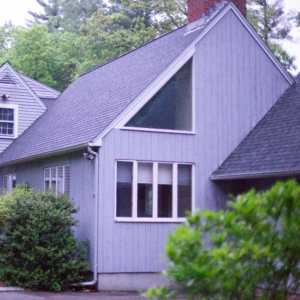

I have very high and steep cathedral roof in my living room and since that addition was built in ’78, it isn’t exactly built to some great insulation standards. Rafters are 8″ deep and currently I have windswept fiberglass there. Have no idea how bad that kills the insulation value, but looking at how fast temps drop in that room gives me sense it isn’t good.
I will be replacing the roofing in about 5-7 years. In the meantime one of insulation contractors is suggesting we cut a slit at the top and bottom of the roof, pull out all the fiberglass, and dense pack those bays with cellulose. I am actually thinking we just dense pack over the fiberglass and skip pulling it out.
Do you think I run a high risk if I do that? 5-7 years I will be putting several layers of polyiso over the roof and doing standing seam.
I am in Zone 5 (Boston)

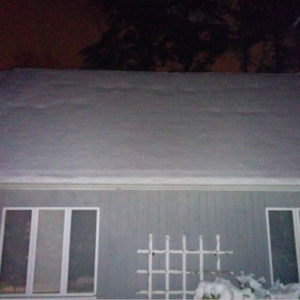

Included picture of where the snow was melting the most last winter on that roof. You can kind of see some nice thermal bridging.
