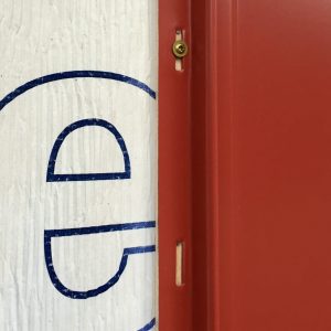

I agree you probably don't need anything like a structural screw to keep the siding in place, but as Tristan posted, you will need something with a pan or flat head, for the hidden fasteners, (not a deck screw), and you don't have any choice beyond brands for the gasketted ones.
I’ve done something like this for a cabin and used GRK cabinet-style screws. I also added narrow rips of 1/4” (nominal) plywood for furring strips as I went along placing the snap seam/standing seam/concealed fastener metal panels. This thin furring is thick enough for a reasonable rain screen gap in some climates and helps with foam compression issues, too.

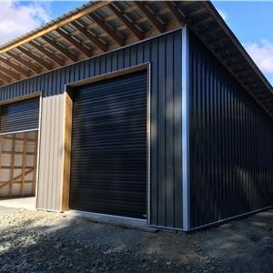

This summer I had a chance to do some GBA style backyard testing of wind pressure on siding while building a couple of shops. They didn't have sheathing, just house-wrap on horizontal strapping behind the metal cladding. Because the metal trim goes on before the siding, there is a period when the house-wrap is exposed to any winds, and initially I was worried it would tear loose, as it threatened to when we just had the first walls done. But once we had all four covered, as soon as we shut the doors the problem disappeared, as there was no way for the wind to exert pressure from behind.
The panels over the roof overhangs, which are exposed from below, had a really aggressive fastener schedule to keep them from blowing away
