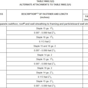

Debra,
The International Residential Code provides a fastener schedule for wall sheathing when staples are used (see Table R602.3, reproduced below).
When it comes to specific requirements for seismic areas and high-wind areas, it's best to consult an engineer.
