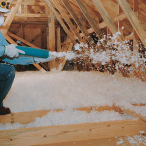

Mark,
Here is a photo of a worker installing blown-in fiberglass insulation. (This brand is InsulSafe. Other brands may look different.)
'That's what I got'. Thanks.
