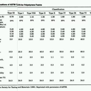

  17. Riversong||#17
    Water absorption by EPS is not a "myth", but the ASTM C 272 test involves 24 hour soaking.
    In actual sub-grade conditions with well-drained soils, actual absorption is much less.
    Type IX EPS is 1.8 pcf EPS with 25 psi compressive strength and R-4.2/inch.
    Standard (type II) EPS has 30 times the water absorption of standard (25 psi) XPS.
    通过标准ASTM测试,以下是蒸气渗透和吸水的比较:
    Foamular 150 (15 psi) XPS
    Water Absorption (% by volume max): 0.10
    水蒸气渗透(perm max):1.1
    Type II EPS (15 psi)
    Water Absorption (% by volume max): 3.0
    Water Vapor Permeance (perm max): 3.5
    Type IX EPS (25 psi)
    吸水(数量最大为%):2.0
    Water Vapor Permeance (perm max): 2.0

    According to the chart you linked to (and any such specifications I've seen) EPS - even at 40 psi - does not offer more than R-4.2/inch.

    Polystyrene rigid foam boards have the inverse quality of fiberglass (which diminishes in R-value as it gets colder).
    Here is an ASTM chart of EPS and XPS specifications:
