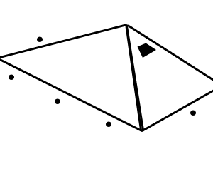

I have a small section of house with a small hip roof of approximately 128 sq.ft. in area. Based on my calculations I was planning to install 5 round 4″ soffit vents (http://www.homedepot.ca/product/4-inch-white-circular-louver-resin/935118) and a single square roof vent (http://www.homedepot.ca/product/60-nfa-brown-roof-louver-high-impact-resin-square-top/935114). From other reading I gathered that the outtake should not exceed intake, so should I install an additional soffit vent to keep the ratio approx. 50 / 50 ?
Here is an attachment with the approximate location of the vents. The roof vent is located in the same spot as my neighbors house, with a similar roof build

Most building codes require 1 square foot of net free ventilation area for every 300 square feet of attic floor area, assuming that half of the ventilation openings are located in the soffit, and half along the ridge. For 128 square feet of attic, you need at least 0.43 square feet of ventilation area (61 square inches).
According to Joe Lstiburek, "Put more vents down low than up high. ... You want more entry points at the perimeter than exit points at the top." So if you have 60 square inches of ventilation up high -- that's what you have chosen -- then you need more than 60 square inches down low.
However, note that the square roof vent you have chosen for exit ventilation is twice as big as you need.
You can use an online ventilation area calculator if you want. Here is one from GAF:
http://www.gaf.com/Roofing/Residential/Products/Roof_Vents/Ventilation_Calculator
To get 60 square inches of soffit ventilation with 4-inch round soffit vents, you need 12 round soffit vents, not 5. That still doesn't meet the Lsitubek requirement -- that's just balanced ventilation. To follow Lstiburek's guideline, you would need more than 12 soffit vents.
Another option: choose a smaller unit for the exit ventilation.

Thanks for the info. According to the calculator and 1:300 ratio (which is code) I need 30.72" inches of venting for soffit & roof. For the soffit vents I'm squaring the radius * Pi (3.14) which gets me 12.56" of venting per unit. That would require 3 vents total, correct? If so, I would need to find a roof vent small enough to cover 30.72".

你是对的,当然,一个圆的面积is π r². However, the net free vent area of a 4-inch-diameter round soffit vent is significantly less than the area of a circle with a radius of 2 inches. The reason is that the louvers and the screening restrict air flow.
Frustratingly, the link you provided to a Home Depot web page doesn't include the net free vent area for this product (unless I'm missing something). However, the online calculator from Gaf.com (see my link in the earlier answer) uses data that show that the net free vent area for a 4-inch-round soffit vent is about 5 square inches -- not 12.5 square inches as you optimistically calculated.
However, if you have a ceiling that isn't airtight, and if you suspect that your insulation level is insufficient, you are definitely barking up the wrong tree. I can't imagine why you're worrying about your attic ventilation level. It's time to come up with an air-sealing plan and a plan to improve your attic insulation.
If your ceiling is leaky, adding attic ventilation canincreasethe rate of air leakage through your ceiling -- increasing your energy bills and making a bad situation worse.
