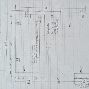

The kitchen in my condo is 82″ x 69″ so I planned to have a Wolf countertop oven instead of a range and a hood. The city building permit office approved the plan but a prospective buyer’s lender insists the kitchen needs a range. Any experience with small kitchens without ranges?

    这就是科罗拉多州博尔德市批准的东西 -

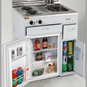

    Mary,
    像迈克尔一样,我认为您需要某种类型的炉灶。如下图所示,这些单元不需要占用太多空间。
