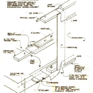

    "The way we’ve been doing that is through a “header wrap” detail where we run inexpensive, 9” wide black non-adhesive six mil poly “window wrap” between the sill seal and the bottom plate wrapping up the exterior of the sheathing and taped to the house wrap and also between the top plate and upper top plate wrapping down over the sheathing and taped to the house wrap. This seals the joint between the sheathing and the exterior of the top plate and terminates the top and bottom of our house wrap."
    这是本页的第24条评论://m.etiketa4.com/community/forum/energy-efficiency-and-durability/19107/airtightness-sans-sprayfoam?page=5
    参见下面的细节。我希望这对你们有所帮助。
  7. 迈克尔·钱德勒||# 7
    对,那是正确的
    在钻完螺栓后,你把头部包裹放在泥台的底部。只是roll it over and tack on the 9" black poly,白蚁闪光和窗台密封然后roll it over and beat it down on the bolts。聚氯乙烯现在将在顶部和窗台密封将反对混凝土。既成事实
    在顶板上,你只需在安装上顶板时附加头包(这样你就不会在设置桁架时走在滑聚),如果你使用干墙垫圈,你有绝缘接头连接到较低的顶板,因为他们的绝缘。这样,当他们挂在天花板上时,他们就不太可能被床单摇杆砸到。
