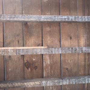

2nd/3rd floor – 1 inch solid 100 + year old wood planks covered by at least 6- 8 inches of stucco.

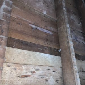

The 2nd/3rd floor stucco with wooden planks and framing.

Is it permissible to use closed cell spray foam insulation on 1 inch wooden plank siding with over laying 6 inch 100 year old stucco? There are gaps between the planks of about 2 inches. I am planning 2 coats if elastomeric paint from Sherwin- Williams to seal the stucco from moisture absorption. Is it his acceptable technique? I always hear of “wood rot” and mold issues in homes?

Any significant thickness of closed-cell foam as cavity insulation will be less than 1 perm, so you'd be significantly changing the vapor profile of this wall. And because I am not familiar with your heavy stucco assembly, I'd be reluctant to make any recommendations. I would suggest that you consult with a local expert on this. Closed cell foam is not easily removed should it cause some sort of wall failure.
Is the ultra-thick stucco bonded to the plank sheathing (like really FAT lath), or is there an air gap?
I could touch felt paper under the stucco- between the spaces of the plank. Should I try to see if there is a wire mesh or lathe underneath??
