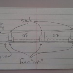

    You've given me a bunch to think about. Thanks. I'm now leaning towards either the full sheets of polyiso or perhaps something like what I've shown in the attached image:
    图像中所示的方案的优点是喷雾泡沫可以在螺柱上圈出泡沫“帽”并形成连续层。我有足够的空间在没有问题的情况下加入1英寸或更多的泡沫。

    If you take the approach as shown in the sketch, use open cell foam trimmed flush with the caps, not closed cell, with vapor barrier latex on the wallboard. The cost will be much lower, the air tightness comparable or better, the difference in whole-wall R would be negligible, the greenhouse gas footprint about 10,000x lower, and you could skip the side-cap detail (just use 1.5" end caps glued/tacked in place prior to foaming.)
    If you went with full sheet iso instead of caps you can skip the v.b. latex, and the open cell foam would be easier to trim (otherwise you'd be nicking your end caps if your not careful.)
