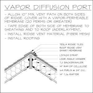

I like to use 14" TJIs so I can get R49, which is in the new 2021 Code, and is not that much more money. Rockwool, fiberglass and cellulose are all good choices for insulation, but do pay attention to the details on the vapor diffusion port. Also, TJIs are straight vs. all the dimensional lumber we get today.
Here is a detail I use...
