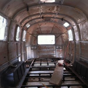

Hi, I’m helping someone renovate an airstream, which is to be a non moveable, room near their house. The house is in upstate NY, on the border between zone 5a and 6a. It’s completely gutted, so it’s just an aluminum can at this point. The plan is insulate it with closed cell foam, 1-1 1/2″ on walls and ceiling, 3″ in floor. That’s all the insulation the frame will allow, unless some more extensive modifications are done. It’s going to be heated in winter with a small propane heater, designed for boats. The interior finish is still being decided, but the owner is leaning towards wood, which would match the interior of the house. I’m wondering about condensation in this situation, and where the dew point would be, but I don’t know how to figure that out. I don’t want the wood, if that’s what we use, to become moist, develop mold, etc. The airstream is 27’6″ x 7’6″ x 6’8″. It has about 60 sq ft of windows in it.
Would appreciate any help

Here's a photo of the gutted airstream
Do you think you'll be comfortable in a trailer insulated to somewhere below R-8?
The idea is to used closed cell spray foam, which should make it a pretty air tight can, so it shouldn't take much to heat it since it's a small space. Also, it's not going to be used all the time, but more as an outdoor hangout for a young boy.
I have no experience with such work, however, the wall and floor skeleton would not be insulated and it would have some serious thermal bridging. I would try to get an extra inch or two and get more CC insulation. Also, I would think a propane heater is bad for air quality; since is such small space, I would think on a small electric heater and maybe combo AC unit if they have humid summers.
You can make a pretty-airtight space out of a plastic garbage bag, but that doesn't mean the bag is well-insulated. So, to amend the question: Do you think the young boy will be comfortable in a trailer insulated to somewhere below R-8?
For the record, I think it's a neat idea, even if most building inspectors wouldn't.
MD, there are millions of people that are comfortable in their uninsulated brick and frame homes, so the answer is yes, the boy would be comfortable in a heated, R8 trailer.
With the heat on, R8 is enough to prevent condensation in most conditions, if breathing is the only source of water, (no cooking). The single glazed windows will sweat and freeze up, though.
99% of all RVs and trailers and boats use propane heaters, so I don't see a problem there either. An air to air heat pump should be cheaper at today's rates.
Kevin, yes, breathing would be the only source of water. There's no plumbing, kitchen, bath, etc. and the propane heater is one designed for boats.
I agree with you that it should be comfortable in there. It's a trailer that's been used for years as portable living quarters, and it's going to be insulated much better than it originally was. It's just that an aluminum can is a different sort of envelope than I'm used to, and I don't want to create an environment that is a problem for wood, if that's what the finish material will be.

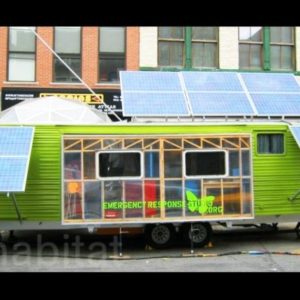

Here's a link and a pic of an old FEMA trailer that was refurbed to be a sustainable artist's den-type thing. I thought it was the coolest thing I'd seen for a long time. I know it's not an Airstream, but neat anyway.
http://www.emergencyresponsestudio.org/
This is another cool project along the same lines:http://www.winkarch.com/project.php?id=65.
