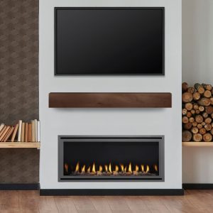

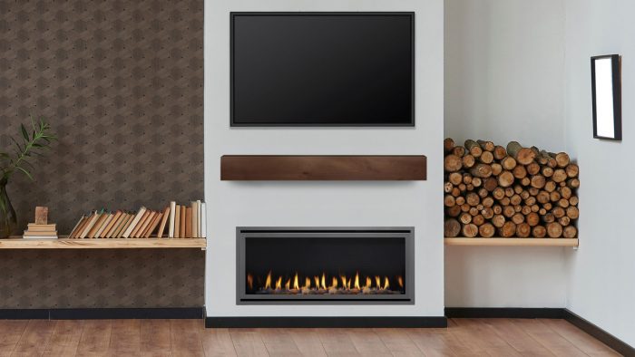

Superior makes some low output models.

If you select one of the linear fireplaces much more of the heat will go up the flue and less in the house. Some of the Heat & Glo unit have an optional thermostatic fan that will pull heat from the unit and allow you to connect a duct and dump the hot air away from the unit or outdoors.

Unrelated to the question -- but I couldn't help laughing at that photo! A sizeable stack of wood next to a sealed gas fireplace... gotta love marketing!
