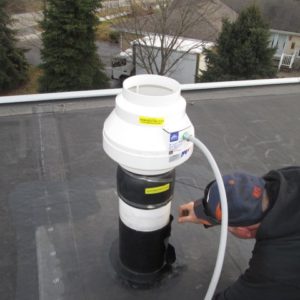

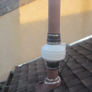

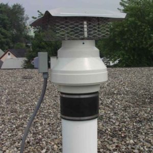

1. I advise you to start with a passive radon system. In many homes, that's all you need. The fan used for an active radon mitigation system may not be necessary.
2. If testing shows that you need a radon mitigation fan, it can be installed above the roof (see photos below). Plan ahead by talking to your electrician.
