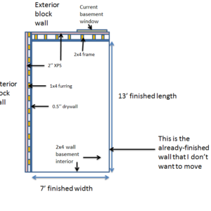

    Hi Martin. Thanks for your response. In regards to the basement window, luckily there is already a small basement window in the space that I am finishing. Thus, I will enlarge it and make it a code-approved egress window in order to consider is a bedroom.
    我已经附上了我打算做的事情的图纸。是的,这将是一个小房间...但是没关系。我试图最大程度地减少已经整理的部分的拆除,同时增加了我家中的成品空间。
    再次感谢,
    周杰伦

    Martin, after thinking about this some more, I realized that I will have to go the route of gluing drywall to the foam itself. I can't acquire InsulPink (won't meet minimum order), and if I use 1x4 furring, then I won't be able to meet the code-minimum for basement wall insulation in my zone. I need R-15, which would be three inches of XPS. I only have three inches of room for the insulation/wall combo, so it will all be used up by the insulation. The only other option is using polyiso...but I have already purchased and brought home the XPS, so I kind of feel stuck with it.
