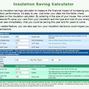

This calculation of savings of $25 a year based on guesses. In term of fuel dollars saved this insulation upgrade may never pay for its self, if you value your time with today's fuel costs.
I am not trying to talk you out of doing this upgrade, I just want you have realist financial expiations for this investment. If you want to go ahead for comfort reasons or to fight global warming, I say go for it but do so with your eyes open.
Walta
Do you think this would take into account the additional efficiency from air sealing?
Either way, appreciate it! Regardless of the answer to that question, looks like utility savings is not one of the main reasons to do the upgrade.

No adjustment was made for air sealing in this calculation.
