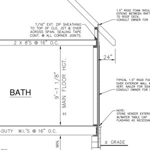

Here is a drawing of the detail in question.
Mark,
I'm afraid I don't know enough about building in your climate to c0mment usefully, but the notes on your section caught my eye.
You should consider omitting both "consult the owner for details" and "flashing as necessary". Both are very problematic notes to have on permit or contract drawings.
Malcolm,
I am actually the GC in this case and all of the exterior details will be handled and installed by me but thank you for your feed back.

I would consider adding a callout or detail page for each of those “consult owner for details” details. Even if you’re doing the work yourself, it’s still a good idea to have a complete set of plans with all details included for future reference.
