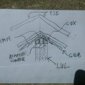

Akos, do you know of an article/diagram of this detail?
"For best results your ridge beam should be bellow your I joists with the air barrier (angled 1/2 plywood wings with taped seam) across the top of it before the TJIs are installed. Your drywall now butts up against these plywood wings and is sealed with a good quality tape. You can then clad the beam to make a nice accent piece."
See attached sketch.
