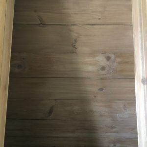

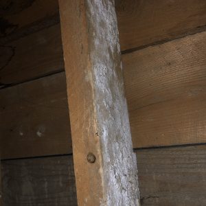

    Slate is/was usually installed on skip sheathing, which wouldn't be amenable to spraying foam from the underside. Have you taken a good look? Can you share some pictures of the interior of the attic?
  2. Andre0170||#2

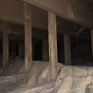

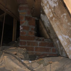

    Thanks Dana - it looks to be t&g but might just be planks. It looks too tight to be skip sheathing but I might be wrong. Enclosed are a few pics just scroll to see them. One is looking at the gable sheathing from inside a 2nd floor closet, one the same from in the attic space, one a wider shot looking into the attic space, and one shot of particular concern looking down the side of the building from within the attic space where you can see a space between a brick load wall and the sheathing... not sure how to get insulation into that space down the length of the building. Thanks for having a look...

    Shot from inside the attic looking at the gable sheathing under the slate

    Wider shot of the attic

    Space between brick load wall and gable sheathing under the slate that runs the length of the building...

    It's probably ship-lap sheathing with #30 felt or similar on top.
    This is one of those rare situations where I'd be inclined to recommend an HFO-blown closed cell foam on the underside of the roof deck. It only takes ~5" to hit code minimum if the rafters are also encapsulated. Going with 9-10" of open cell MIGHT work on the underside of the slate section, but could be risky under the TPO roof.
    I'm not sure quite how to deal with the long skinny triangle space with brick on on one side and the roof deck & rafters on the other. If it's a south facing pitch with slate on top it's reasonably safe to dense-pack it with cellulose (even though that would technically be a code violation) by installing air barriers on the ends and stuffing it full. If north facing that might be too risky.

      >"I'm not sure quite how to deal with the long skinny triangle space with brick on on one side and the roof deck & rafters on the other."
      If it's not too deep, a spray foam crew would probably be able to get in there from each side and build up a thick enough layer on the underside of the roof sheathing to be OK. From the look of the hole between the brick and the rafters/roof, I don't think there would be enough clearance to get a foam gun in there and make a bend with the hoses attached, but I think it would be possible to get enough coverage from the two sides at a bit of angle that the foam expansion would fill in sufficiently. It might not be the most pretty part of the install, but it should work.
      It's very difficult to judge the depth of that hole though. If it's much more than 3-4 feet from one end to the other, then it might be a problem to get full depth on spray foam in the middle part.
      Bill
      1. Andre0170||#10
        It would appear that the hole runs the length of the building along that support wall - rounghly 50 feet from end to end. Seems weird that they would have let that stay open...
        1. Expert Member
          Zephyr7||#11
          That's going to be a very difficult space to insulate well. If the rafter cavities are open from the top side of the brick wall, then it's probably possible to foam down from above. If there is blocking up there, then that's probably not an option. I don't think a dense pack crew is going to be able to fill that entire space either.
          If you'll have polyiso above the roof sheathing, your best option might just be to accept a little less insulation in that relatively small area, and rely on the polyiso to keep the sheathing warm enough to avoid any moisture isssues in "the void".
          Bill

    We can... just trying to find the most cost effective way to get the best result. Increasing polyiso on the roof may not make as much difference if we’re blowing foam anyway, due to the increased cost of the poly vs the labor involved in cracklings around in that space blowing foam. The triangular space is on a west facing wall - and the same likely on the east side, just haven’t crawled all the way in to look. If dense pack cellulose in that space, only what would be the risk to the tpo? Unless it’s because there isn’t venting in the space?
