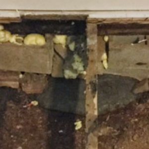

I just tore out the bedroom subfloor in our 1930s country house. We were having mold issues and the crawl space was less than 10″ high so I could not accesss it.
Previous owners randomly shoved fiberglass insulation in there, which was a nesting ground for possums and squirrels.
I got all that cleaned up, and amazingly the rough sawn tar covered joists (2x10s 24 OC) are in great shape without any mold. The insulation was a mess of wet and mold, so my ideal is to somehow seal the crawl space and use no floor insulation between the joists.
The sill joists sit on dry stacked concrete block which are not square to each other, and are broken etc in places. The level is achieved with stones etc on top of the short wall. I think the only way to seal this is to use spray foam.
My questions are: Do I try to affix some sort of insulation to these rough walls? Would it be better to simply fill the block voids with great stuff and put a good vapor barrier down on the dirt floor? Do I leave the voids in the vent blocks open or seal them (they are simply concrete blocks turned sideways)?
Any other advice on this? Part of my though is just to warm the floor with a heating mat on top and leave the crawlspace uninsulated as it originally was built aside from sealing with foam and vapor barrier.
The home is in Asheville NC. We get virtually daily rain in the summer so it can be quite damp. Winter lows well below freezing, but average is not too bad. The moisture is well managed on the perimeter of the house.

I've seen some funky-looking concrete block walls in my day, but your foundation may get the prize.
