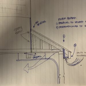

I’m using your technique above - I drew up a little something for clarification.
将4英寸的闭孔喷雾泡沫直接施加到屋顶护套的下侧吗?你还会将4“申请到”膝墙“
Finally what would be the best method to block the vented soffit? Place foam board perpendicular to the soffit vent (seal between rafters)or parallel (use spray foam to completely fill the soffit cavity). Would a perpendicular approach lead to ice forming above the soffit?
嗨m_g_k(对于GBA问答社区有一个真正的名字) -
键是为您的条件空间获得连续的空气控制层:卧室和车库的新条件空间。我知道你只是希望锻炼你的车库,但你不能“有点”有一个限定这些空间的空中障碍。车库在里面,空气控制层的位置占据了这个空间,否则是它的。
You can install a shed roof ridge vent: see this example:https://dciproducts.com/shed-roof-roof-to-wall/。老实说,我不知道这些工作有多好,但我打赌如果你的棚屋看到任何太阳,那将把空气流缝制到棚屋“山脊”。
我不是说你不能改变单坡屋顶space to a conditioned space and air seal/insulate at the roof line; it's just that if you don't have a good reason to pull that triangular attic of the shed roof into conditioned space, why do it.

Whoa!!! That link to the vent you provided is amazing!
实施该产品完全解决问题。
我无法妥善表达对您的洞察力以及对该论坛的贡献表示感谢!非常感激!!
