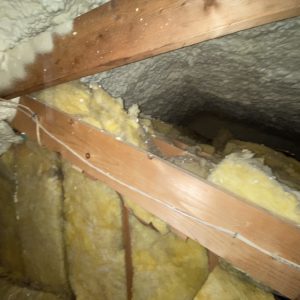

Thanks so much for the reply. Here’s a photo of the portion of the attic by the guest room. You can see that the right side of the guest room ceiling has attic above it, but the left side is not accessible from the attic. The ridge vent of the house was at the top of the photo, and appears sealed. Unless you think it is possible that there are ventilation baffles above the spray foam that are still somehow operational?

It's possible the spray foam installers may have put in vent baffles to keep the ridge vent connected to the part of the roof they weren't foaming. I would certainly check that to be sure though. If the ridge vent is sealed, you can use a roof vent like this (there are different styles, this is just one example):

If you go with spray foam for the rest of that roof, I would use closed cell (safest), but open cell is probably OK too.
