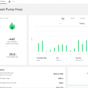

I have a Sense monitor that was given to me by Green Mountain Power. It does an excellent job of monitoring total electrical use and production from my solar panel. It successfully identified a bunch of my minor devices -- microwave, garage door opener, toaster, etc. It has not been able to identify the heat pump, the water pump, the refrigerator. For appliances that plug into 115v outlets you can get an inexpensive sensor that informs the Sense how much power is being used. However there is no inexpensive solution to monitoring the heat pumps. Though I am curious about how much power they use I am not ready to spend hundreds of dollars to find out.

I concur with Jayson on Sense. I have one and applaud the user friendliness and accuracy, but the ability to "detect" devices is dubious. Because of this fact I purchased their add on CT's (limited to two) and monitor my heat pump circuit. This takes the guesswork out.
