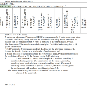

However, I found something interested in the RI building code as listed on their website (attached). Unless I am missing something, even though we are in Zone 5, basement walls only need 10/13. I will need to verify with the inspector. With an R-10 continuous rigid foam on the interior walls the 3.25" EPS would be sufficient.
