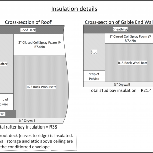

    Dana,对于更多背景,请注意,我实施了您的绝缘建议//m.etiketa4.com/question/weighing-zesulation-options-for-tatic-roof-dable-ends.。简而言之,所有外表面都是闪光灯和BATTED与BONFIGLIOLI条带。实际上我有一个图纸 - 见附件。在天花板的平坦部分上方有足够的房间。
    My design temperatures are 16.3 and 93.2 deg F. I based the crude heating load calc (i.e. conduction loss only...and emissive assuming that is rolled up in window U-factor) on the observation that over winter the 2nd story did not drop below 60 deg F due to heat rising from the first story. So I figured that the heat gain from downstairs is equal to the heat loss at 60 degree inside temp and 20 degree (conservative guess) outside temp. Subtracting that from the loss at 70 deg inside, 16.3 outside I get < 300 W. That does not include air exchange but it's theoretically pretty tight. So it would appear a space heater would easily meet my heating needs.
    为了冷却,我使用传导和假设的阳光(连续)正常到我的0.22 SHGC Western Windows作为一个简单的限制案例(再次,忽略空气交换)。但我现在刚才意识到我使用室外空气温度而不是表面温度的错误。目前西屋屋顶比环境温度50°,西部壁板比环境温度更热。因此,将那些夏季设计的临时加入〜5400 BTU / HR进行冷却(是的,在此处使用不同的单位)。所以现在,9000 BTU / HR迷你分体并不像我第一次想到的那样令人震惊的。
