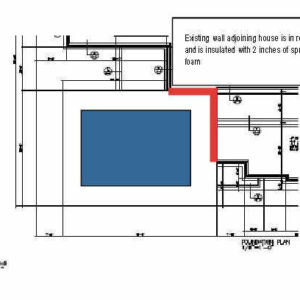

    Touching the exterior is not an option I will be given. Would you add the foam board over the spray in to minimize the thermal bridging at the studs?
    I have attached a diagram of the house attachment.
