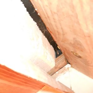

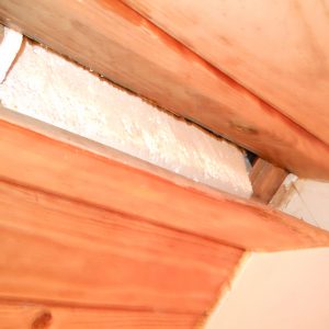

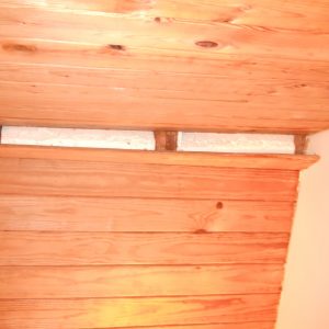

Attached are some photos.

I was able to pull down one the T&G boards.
Sections of 2x6 rafters with styrofoam in each section.
Black felt paper above the styrofoam with board over that.
You really want an air barrier behind that T+G ceiling and it looks like you don't have one. You might want to consider taking down the T+G, then putting up some polyiso over the rafters on the inside, then put the T+G back up over the polyiso. This will cost you some ceiling height, but it will gain you insulation, cut down massively on thermal bridging from the rafters, and will give you a good air barrier too. 2" of polyiso is R13, 1" is R6.
If that's loose fill styrofoam beads, it's all going to come out on you during this project and will make a huge static charged mess. You'll likely never get all the beads cleaned up. I would contract to have these sucked out by a vacuum cleaning company (construction cleanup companies can do this kind of thing), then pull down the boards. You could reinstall mineral wool batts afterwards.
Ideally you either want a vented roof or spray foam between those rafters. Polyiso's one down side here -- assuming you use the regular foil-faced stuff -- is that while it will help to limit moisture and air from getting up into the roof, it will also prevent any drying to the interior. Keep that in mind.

It is thick blocks of foam in the rafters.

>"It is thick blocks of foam in the rafters."
How thick?
Type I or Type II EPS runs about R4.2/inch when the mean temp through the foam layer is 75F (the test condition for it's labeled R-value) , closer to R3.5/inch when the mean temp through the foam layer is 110F, even less when it's hotter, which may be what you're experiencing when the ceiling is 90F+.
IRC 2018 code minimum in Austin for insulation installed between the rafters is R38, which would be 9"of EPS. From the pictures it appears to be about 4" (R16.8), but it's hard to tell for sure. If it's a full-fill of rigid EPS between 5.5" deep milled 2x6s it's R23. That's still WAY below code, and it looks like the assembly is extremely air leaky to boot.
