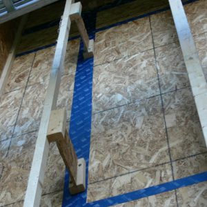

    Chris Corson's current project is using a similar method (airtight taped OSB sheating with TJIs bolted to the exterior, covered with MENTO Plus as blow in membrane for cellulse). Picture of trusses setup before membrane installation is attached. It doesn't get much more vapor on the exterior than this.
