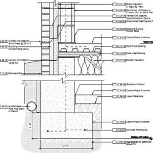

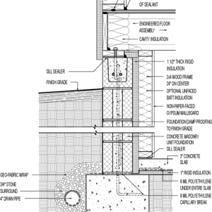

I'm not an engineer. But it is worth pointing out that many published details show the slab overlapping the footing with an intermediate layer of rigid foam. See details below.

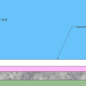

the thing that is unique in my case is that in order to maintain a 4" slab thickness over as much area as possible, I would have to step the slab down to 3" over top of the footings as shown in the picture. I am worried that the step is a stress point where the concrete might be more likely to crack.
