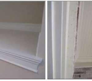

After more reading, I was having the same concerns about trying to manage a pour so there were no void or blowouts. Here is a photo that might help you visualize the entry way.
So it's fully conditioned space on the top side of the assembly, and an outdoor ceiling on the bottom side.
