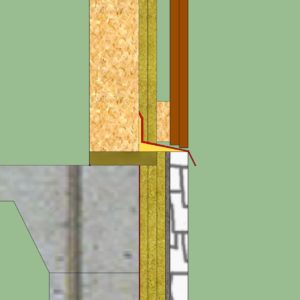

4. My main wall assembly has an overhang, past the foundation, of 4.5″ to the outside of the battens, the board would add another 1″ thickness to the wall. That would make it possible to increase the foundation insulation thickness to 3″ R12.9 and you would only see the sill flashing between the boards, in the reverse board and batten siding. Would it be worth it, to add another layer of drainboard to the foundation? My cost for that is only about $1000 more for the extra inch.
5. Is it possible to put 2×4 strapping over mineral wool board insulation that is 2″ thick, and still attach reverse board and batten siding to the studs safely?
6. The major problem is the sill plate has no thermal break, or insulation. I do not know how to insulate that area, and still provide a good attachment point for the cement board.

Yes the 2x10 is a big thermal bridge, I am not sure how else to deal with that transition. But that is the only bridge to deal with really. i was thinking I could use a 2x8 sill, and just put a 2" wide strip of 1.5" thick foam under the inner half of the 2x6 wall that would be overhanging the narrower sill plate... Hard to vision with words, i will work on posting a drawing tomorrow..

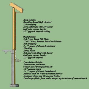

Here is my wall sketch.

I did a google sketch of the wall.
I will try to post it here.

Jesse. This is a barn/shop for now.. It may one day become a house... Never the less.. I am putting extra money into it, as I will need to keep its contents from freezing. There will be wood working equipment in the basement, and lumber and equipment storage in the upstairs, as well as a couple vehicles... Thats why I have a concrete main floor thats 12" thick.
I want to heat with hydronic in floor heat, with hot water solar panels, and passive solar. So a well insulated building is a must.
I can put sheeting on the wall, if thats the way to do it. The Engineer says its not required, because I am strapping it with 2x4 for the reverse board and batten. BUT,, if it serves a double purpose, I will put it in.

As stated before, I am required to have a retarder, and Membrain is accepted by our building code. Here is our Government report on Membrain, has some good installation drawings as well.http://www.certainteed.com/resources/MemBrain_13278_e.pdf
And as my building inspector will probably require a film a something, poly, plastic, membrain or paint, on the interior side of my wall, I will likely go with the membrain product. IF I can find it, the suppliers here dont seam to be carring it
However: I do not agree that water or water vapor will be continuously driven into my "open wall" due to a lack of Weather Resistant Barrier on the outside, as OSB sheeting would provide... The wall cavity will be air sealed, with the vapor retarder on the inside. That will make my wall a pressure equalized or vented rain screen, kinda... If the air pressure outside is higher than inside, there will be air movement into the building. AND there will be moisture laden air movement into the wall assembly, thereby saturating the wall cavity with moisture vapor, but only until the pressure is equalized. The moisture that does get in as far as the interior vapor retarder, be it poly, or painted GWB, will certainly condense on that product during the summer cooling season if the temp at the retarder, is at the dew point.
I dont think with that much insulation, the dew point will rarely be that far in my wall. Am I wrong?
My summer temps, are rarely over 87F but the humidity is generally high, 60% or more.
There will always be cracks and holes in every building, that is impossible to completely account for, even with the most meticulous builder. So, that is why I think an "open wall" is a better choice than one with a foam vapor barrier on the outside, and a plastic, or paint barrier on the inside.
The use of Tyvek, and other house wraps was intended to block the passage of bulk water, driven by capillary or wind, or hygroscopic pressure, into the wall given the poor design and installation of some sidings. Felt or tar paper was used before we had the plastic stuff... But was for the same purpose.
I have replaced that layer with an insulating WRB roxul board insulation.

A couple of years ago, I found Jesse and Darcy Lackman's blog about their Energy Efficient house project. They posted a picture of their method of reducing the thermal bridging in the roof. They cut rigid board insulation into strips and attached the insulation to the rafters. Then they insulated the cavity with batt insulation. Cutting the rigid board into strips saved on their costs.
They didn't post any comments about this solution, but they did include a picture at this link.http://www.wrtc.com/rvsrchjl/house/jfoam.jpg
This method could be an energy efficient compromise for you. If you use a circular saw to cut the insulation, it would be wise to attach a vacuum to the saw. The tiny chips of insulation pick up a static charge which makes them cling to everything, including dogs and cats. If you cut the board outside, the wind blows the light pieces everywhere. The vacuum makes the clean up easier.

Hey, just wondering why you wouldn't use the entire sheet? just to save costs?
It certainly does take care of the thermal bridge..

There are several reasons to take the time to cut the XPS into strips. As your question indicates, the first is cost. XPS costs quite a bit more than Roxul and even more than fiberglass or cellulose. The main benefit of the XPS would be to reduce the thermal bridging while supporting the roof deck.
As an example of the economic benefits of using the strips, assume the insulated area of one half of your the roof is 32 feet long and the insulated slope is 16 feet. That's 512 Square feet. If you used full size 2 ft by 8 ft sheets, you would need 32 pieces. In Eastern Ontario, 1.5 inch XPS is about $18.00 CDN per sheet. If you cut the insulation into 1.5 inch wide strips and allowed 1/8 inch for the saw kerf, you would get about 14.75 pieces per sheet. Assuming the rafters are 24 Inches OC, you would use about 2.3 sheets for the bridging strips on half the roof. This saves the cost of 29+ sheets of XPS. The roof would be cheaper to insulate.
