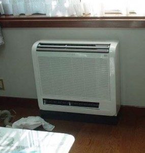

If the mini will be used mostly for heating ask for the floor mounted unit.
