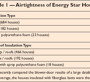

    The best data on this issue were collected by researcher Bruce Harley. I reported on his findings in the April 2005 issue ofEnergy Design Update.
    Harley reviewed blower door test results from 906 recently build New England homes, and sorted the data by insulation type. The data clearly showed that homes insulated with cellulose (average air leakage, 0.31 ACHnat) were tighter than homes insulated with fiberglass batts (average air leakage, 0.38 ACHnat), and homes insulated with spray foam (0.26 ACHnat) were tighter than homes insulated with cellulose.
    这是本文的一些摘录:
    “最近,马萨诸塞州韦斯特伯勒的保护服务集团住宅能源服务技术总监布鲁斯·哈雷(Bruce Harley)能够在许多建筑物中研究气密性和绝缘类型之间的相关性。单户家庭和多户住宅)于2004年在马萨诸塞州和罗德岛州完成。所有房屋在完成后都经过了打击器门的测试。
    "...Harley found that houses with walls insulated with spray polyurethane foam were significantly tighter than those houses with walls insulated with cellulose, and that houses with walls insulated with cellulose were significantly tighter than those insulated with fiberglass...
    "Although the data clearly show a consistent correlation between insulation type and airtightness, the reasons for the correlation are unknown. It is possible that builders who choose cellulose or spray foam insulation — both of which have a reputation for resisting air flow — may be more meticulous in performing air sealing tasks than builders who choose fiberglass batts. Perhaps builders’ attention to detail in certain areas unrelated to insulation performance — for example, careful sealing between wall bottom plates and subfloors — partially explains the measured differences in airtightness. If this theory is true, the extra dedication to air sealing may be motivated by the builders’ desire to justify the added cost of spray foam or cellulose over fiberglass batts.
    "However, the principle of Occam’s Razor favors a simpler explanation: that the measured differences in airtightness are due to differences in the material characteristics of the different insulations."

    I think it's a bit disingenuous and misleading to claim a significant difference between 0.26 and 0.31 ACHnat. That's probably within the margin of error, and it compares averages which can be skewed by the extreme ends of the curves rather than medians. It also fails to compare houses that are entirely insulated with one insulation type, separating wall insulation from ceiling insulation. So it's not clear from the article how useful or accurate the conclusions are.
    我最后的测试在0.10 ACHnat密实充填ADA的房子(0.15 with the air inlets open), and that's a significant reduction in air flow from any of the Harley average numbers.
    I stand by my statement that spray foam will be somewhat more air tight than dense-pack.

    The data are in fact significant -- not only because of the differences in air leakage rates shown, but because of the consistency of the correlation. Bruce tried looking at various subsets of the measured houses and each subset showed the same consistent correlation.
    So the results are significant from a statistical standpoint. The results demonstrate a correlation.
    That said, you can, of course, build an extremely tight house that is insulated with cellulose.
