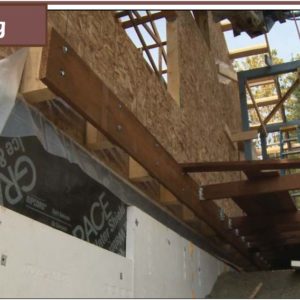

然而,在我们的第一个项目允许被动的房子ect we used 4" of rigid on the exterior, and supported ledgers for both deck and roof overhangs with bolts through blocking, a detail developed by our structural engineer. The blocking was 2x perpendicular to the rim joist. There were two bolts in each block, top and bottom. We are in Seismic Zone 3, btw. Of course they have to be properly sized and spaced for shear. He explained how it worked thusly: In order to fail, the bolts would have to elongate, which they can't do.
Edit: Pictures of the latter detail right in first post in this thread, John Brooks link to the REMOTE manual!
